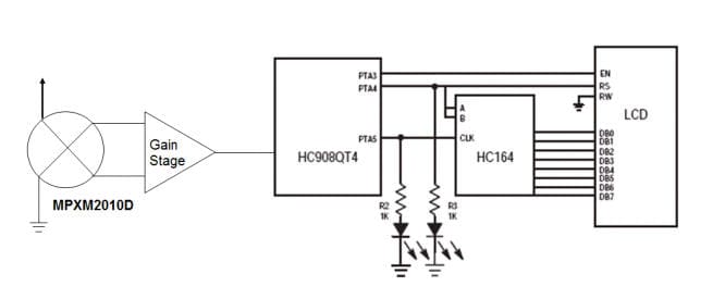

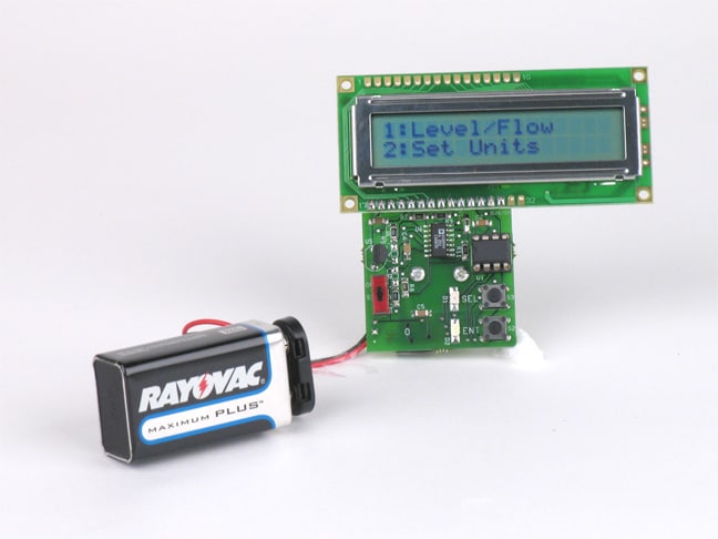

The Water Level Reference design continuously monitors water level and water flow using the temperature compensated MPXM2010GS pressure sensor in the low cost MPAK package, a dual op–amp, and the MC68HC908QT4, 8–pin microcontroller. This system uses very few components, reducing the overall system cost. This allows for a solution to compete with a mechanical switch for water level detection but also offer additional applications such as monitoring water flow for leak detection, and the other applications for smart washing machines.

  • Demonstrate Water Level Monitor plus additional features such as water flow monitoring and leak
  • Pressure Sensor - MPXM2010
    • MPAK Package
    • Sensitivity 2.5 mV / kPa
    • Pressure Rating 10kPa (Max)
  • Microprocessor MC68HC908QT4
    • 40K Bytes of in-application reprogrammable Flash and 128 Bytes of RAM
    • High performance, easy to use, HC08 CPU
    • 4 Channel 8-bit analog to digital converter
    • 8-pin DIP or SOIC packages

  • Isolate pressure sensor from water by using a head tube
Accuracy
  • To prevent overflow and control consumption of water
  • Auto-zeroing concept can eliminate offset errors
  • Tank/tub diameter is irrelevant, the important part is to have an accuracte look up table to correlate water height versus pressure
Printed Circuit Boards and Schematics
RD1950MPXM2010SCHEM
RD1950MPXM2010SCHEMATIC
