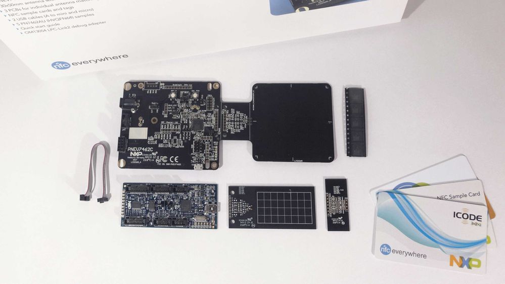

OM27462CDKP: NFC Controller development kit

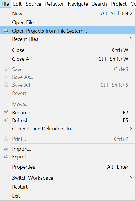

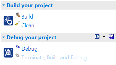

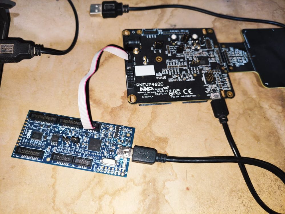

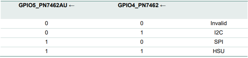

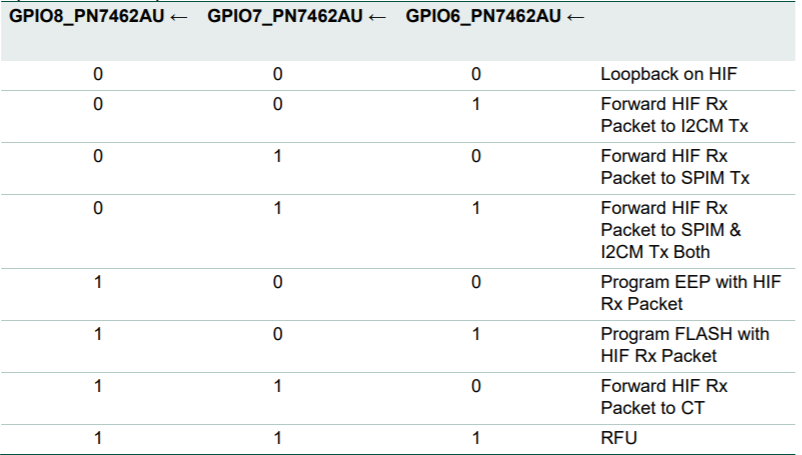

  6. Connect the two cards to the pc
  7. Debug the Project
