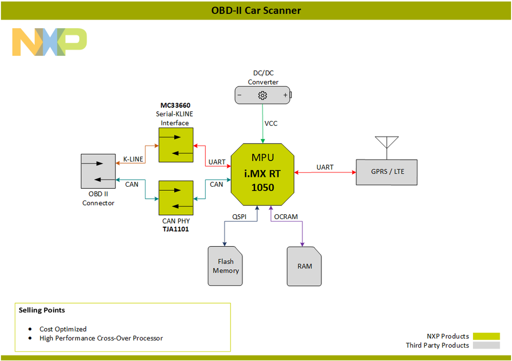

Block Diagram
Products
Category Name MCU
Product URL 1 MIMXRT1050-EVK: i.MX RT1050 Evaluation Kit
Product Description 1 The i.MX RT1050 EVK is a 4-layer through-hole USB-powered PCB. At its heart lies the i.MX RT1050 crossover MCU, featuring NXP’s advanced implementation of the Arm® Cortex®-M7 core.
Category Name Serial Link Bus
Product URL 1 KIT33660EFEVBE: Evaluation Kit - MC33660, ISO K Line Serial Link
Product Description 1 The KIT33660 evaluation board supports the MC33660, a serial link bus interface device designed to provide bi-directional half-duplex communication interfacing in automotive diagnostic applications.
Category Name Transceiver
Product URL 1 TJA1100HN: Evaluation Board, TJA1100HN 100BASE-T1 PHY Transceiver
The TJA1100HN customer evaluation board is a low-cost hardware development tool which supports the functional evaluation of the TJA1100HN 100BASE-T1 PHY transceiver.
