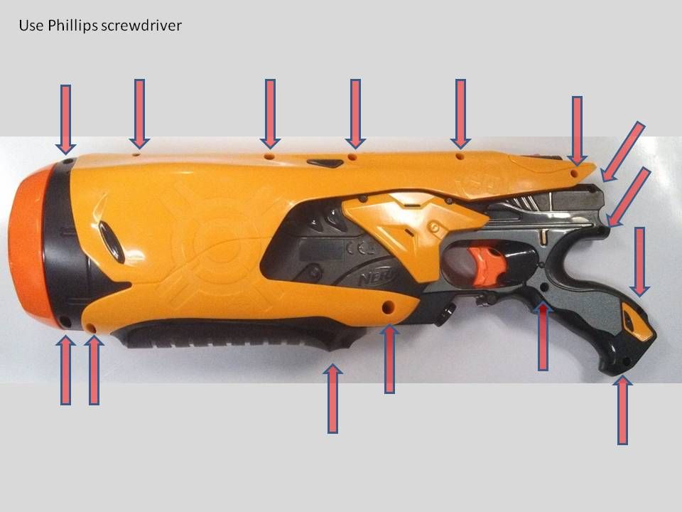

There is no shortage of screws with this Nerf Gun.  So get out your Phillips screwdriver and go to town.

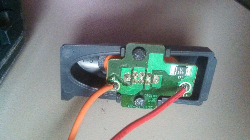

This is the electrical trigger.  The trigger goes to our relay, which is either on or off.  We did try at first to use a 7.2V R/C car battery, but the Nerf draws too much power and didn't fire.  Going up to a 11.1V LiPo fixed that right up.

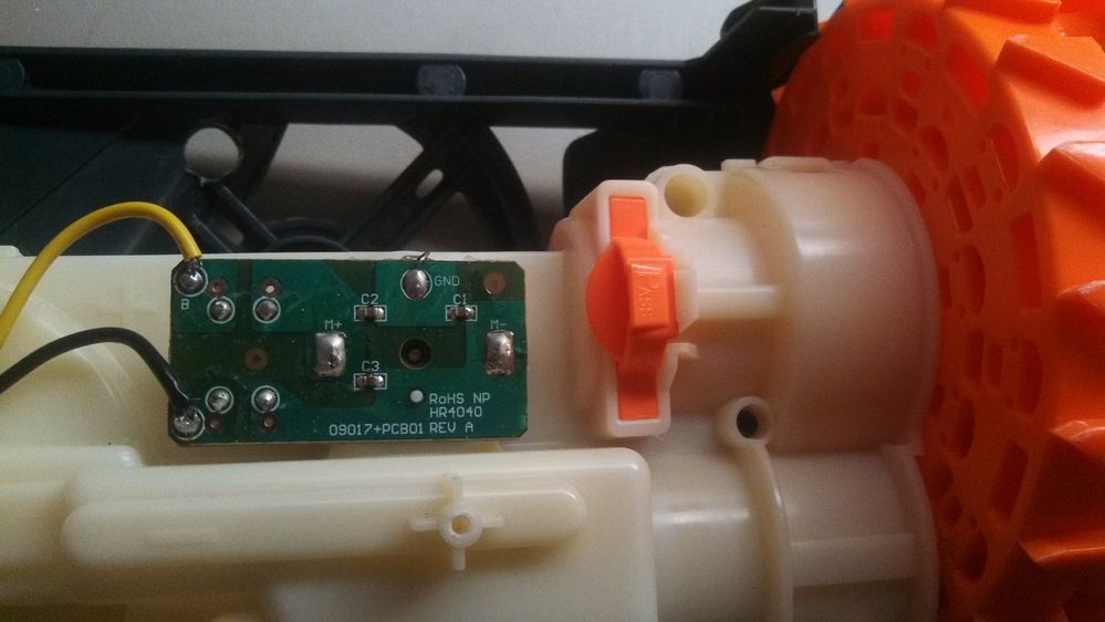

This is the power switch.

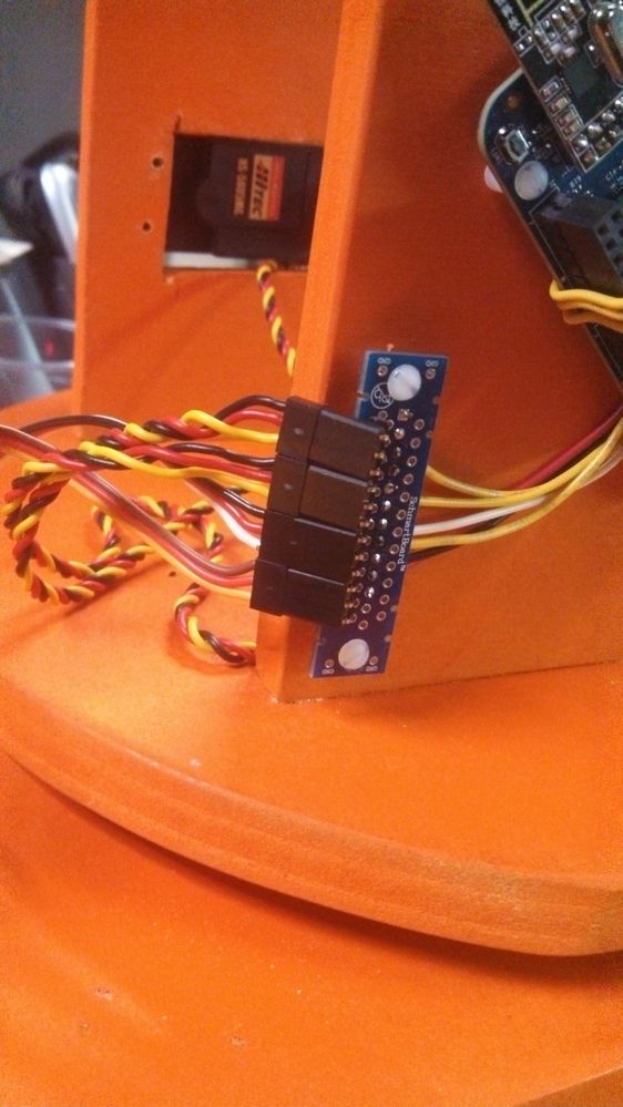

In Nerfinator 1.0 everything was hardwired together, which prevented us from completely pulling the Nerf from the base and made repairs difficult to say the least.  Nerfinator 2.0 we put this handy connector which allowed us to completely and easily remove the Nerf from the base.  Shipping this thing around the country will take a toll on it!  On that subject, Nerf 1.0, stopped cycling to the next position for us at the Austin Mini Maker Faire.  After a through inspection of the operational mechanics inside the Nerf (really cool BTW) it was a little bitty spring that was causing the piston not to fully retract.  We replaced the spring with 1/2 a ballpoint pin spring and to our surprise it all worked again.
