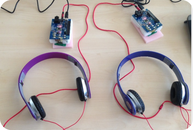

Headset version
Same use case can be shown with NFC headset, with smartphone being connected to the first headset by simply tapping to the smartphone, and then tap the 2 headset together to share the audio content to the second headset.

Headset version
  • Share immediately your music with your friend, or neighbour in public transportation, by simply tapping both headset
  • No need to connect your friend or neighbour’s phone to your phone, simply tap both headset
  • Disconnect/unpaired by tapping again both headset
