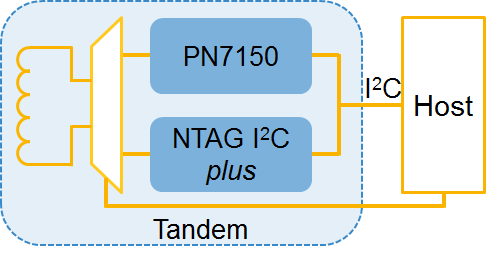

NFC Tandem offers best of both worlds:
An NFC reader and a passive connected tag sharing one antenna. A user can interact with the device when it is powered off (through the NTAG I²C plus); when the device is powered, it can interact with cards, P2P devices or other connected tags.pastedImage_2.png

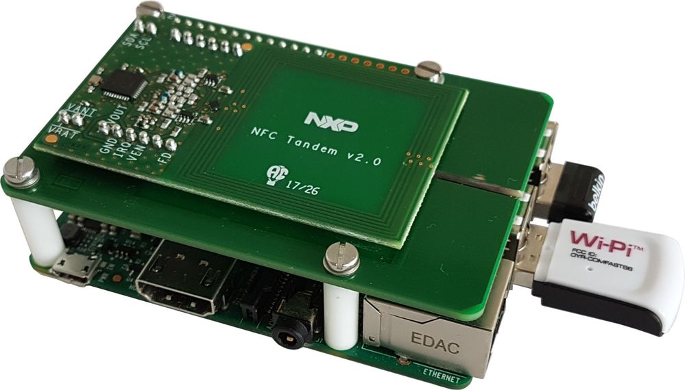

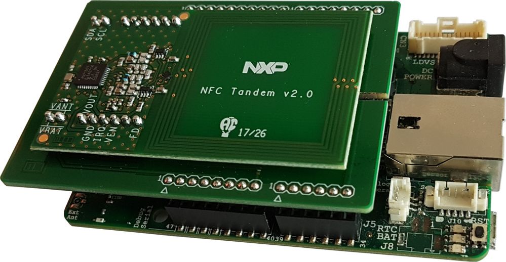

NFC Tandem Demo:

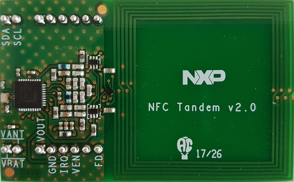

NFC Tandem concept is demonstrated using NFC Tandem reference board:
The demo can run on either:
UDOO Neo
Download UDOO Neo demo image
or
Raspberry PipastedImage_3.jpgDownload Raspberry Pi demo image
