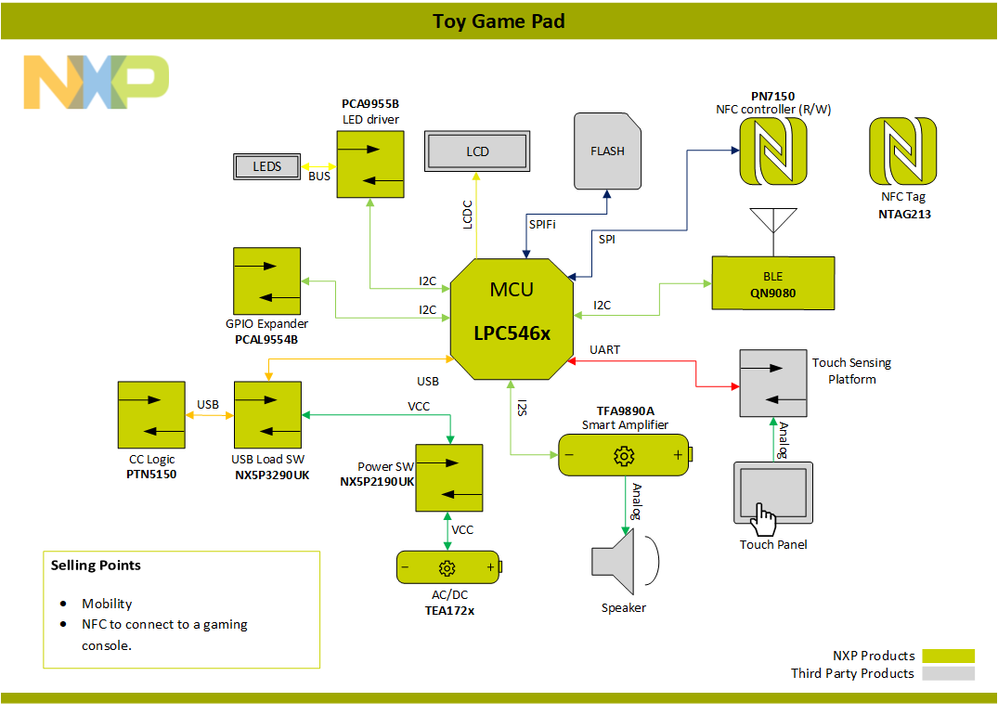

Description
A gamepad is a device used to interact with a videogame through a PC or console.  This gamepad in particular, includes an LCD display and touch panel for a better gaming experience.
In addition, as the play environment becomes more mobile and a game can easily be connected to any network (at a friend’s house, an Internet café, a community gaming center or even an amusement park) NXP offers secure, connected devices and technologies. Add in our sensing solutions with high-performance sensing capability, processing capacity and customizable software, power management ICs and wireless charging solutions to get a complete system solution.
Features
  • LCD Display
  • Touch Panel
  • NFC Pair
  • BLE connectivity
  • USB Type C
  • LED driver
  • Smart amplifier for speaker
Block Diagram
