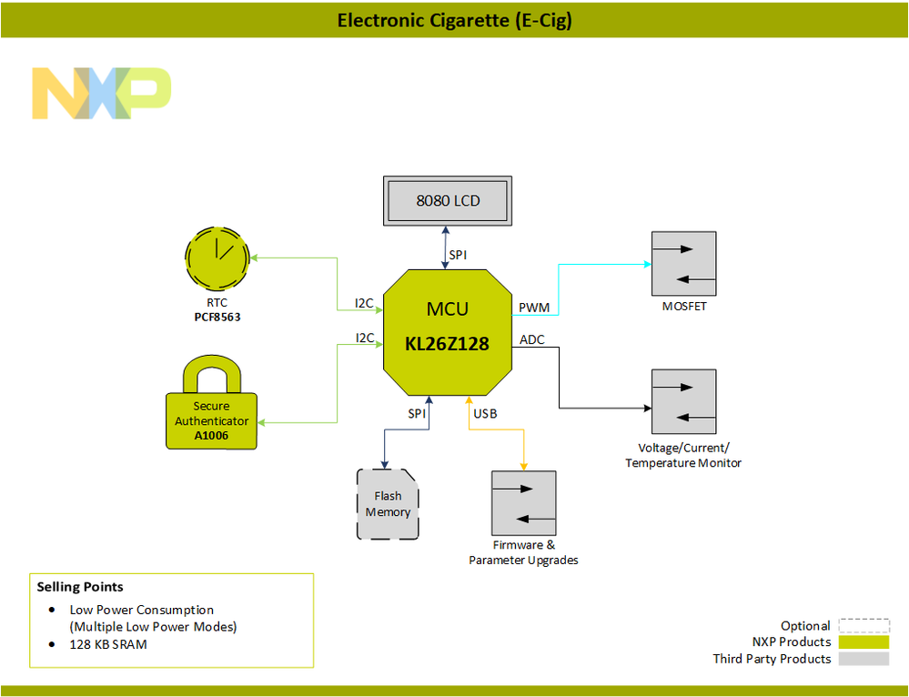

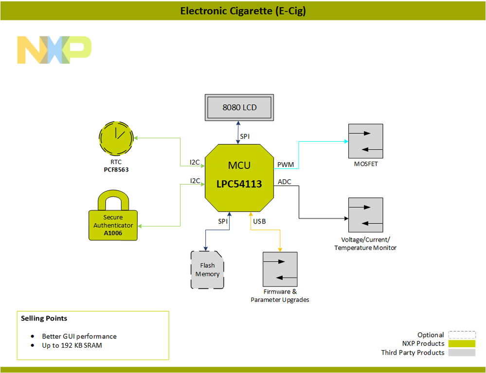

Description
E-cigs is a battery-powered device consist of an electronic cigarette that converts liquid nicotine into a mist, or vapor. It offers an interactive display that allows checking for the battery of the e-cig, liquid nicotine levels, temperature of the device, etc.
Block Diagram
Products
Category Name 1:
Microcontroller
Product URL 1
https://www.nxp.com/products/processors-and-microcontrollers/arm-microcontrollers/general-purpose-mc...
Product Description 1
The KL2x is an ultra-low-power MCU family that adds a full-speed USB 2.0 On-the-Go (OTG) controller and a 16-bit ADC with configurable resolution. The KL2x also features a FlexIO module that supports a wide range of protocols including UART, I²C, SPI, I²S, PWM waveform generation.
Product link 2
Product Description 2
The LPC541xx is a single-core or dual-core MCU, In an always-on application the MCUs operates in a power-down mode, listening for incoming data, which when available, can wake either core to acquire or process the information. The LPC541xx has a 12-bit ADC with 12 input channels and with multiple internal and external trigger inputs and sample rates of up to 5.0 MSamples/sec.
