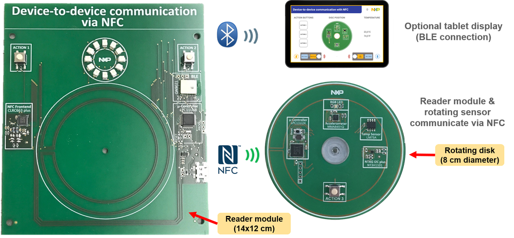

Device-to-device communication demo functionality
The purpose of the demo is to illustrate how to enable device-to-device communication via NFC. It consist of:
  • A base board of 14x12 cm, which embeds the CLRC663 plus NFC reader IC for the RF field generation.
  • A sensor embedded on a separate, rotating sensor disk of 8 cm diameter, which embeds the NTAG I2C plus connected tag.
The base board and the rotating sensor disk communicate via NFC and optionally, a tablet display can be connected via a Bluetooth Low Energy (BLE) connection (the BLE connection is beyond the scope of this post entry).

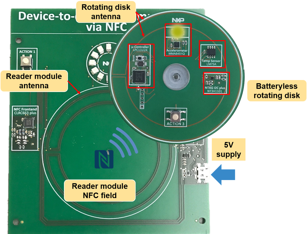

Hardware details
This section shows the architecture and main components of the base board and rotating disk.  The PCB schematics are attached at the end of this post entry.

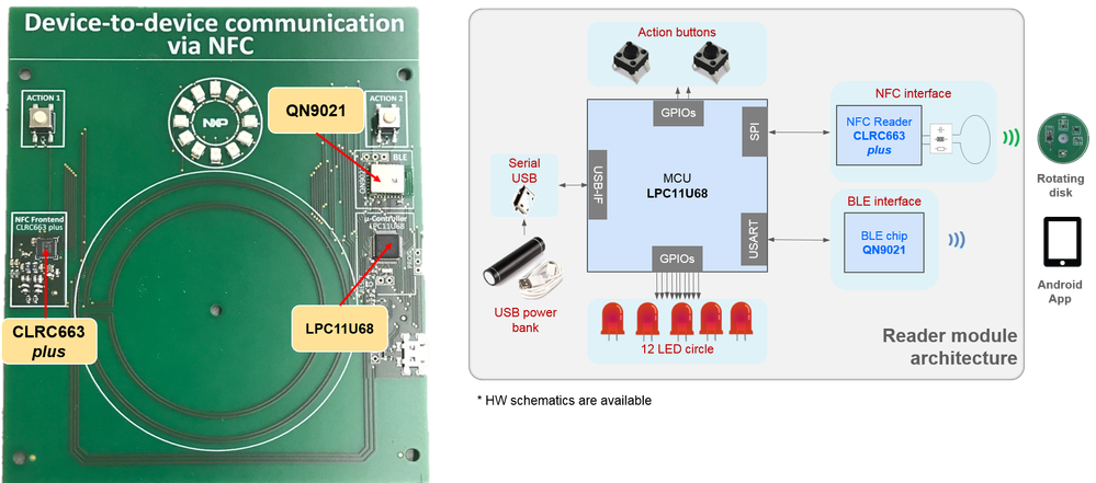

Base board based on CLRC663 plus
The disk has been dismounted so you can better appreciate the different components of the base board. The base board is driven by an LPC11U68 MCU, which is a low-cost Cortex-M0 USB solution, with 256 kB of flash memory, up to 80 GPIOs and several host interfaces (more details on the LPC11U68 product website).
From the LPC11U68 MCU, some of the GPIOs are used to connect the action buttons and the 12 LEDs of the circle, an SPI port is used to connect the CLRC663 plus NFC Frontend and, a USART port is used for connecting a BLE chip based on NXP's QN9021 chip.
The NFC functionality is provided by our CLRC663 plus reader IC, an NXP high performance multi-protocol reader. It is the evolution of CLRC663, with a larger LPCD detection range, more output power (2x times higher transmitter current), larger temperature operating range and pin-to-pin compatibility with the former version.

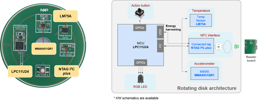

Rotating disk based on NTAG I2C plus
The rotating disk is based on NXP solutions as well. This PCB board is driven by an LPC11U24 MCU, which is a low-cost Cortex M0 32 bit MCU, with 32 kB of flash memory, up to 40 GPIOs and several host interfaces (more details on the LPC11U24 product website).
From the LPC11U24 MCU, some of the GPIOs are used to connect the action button 3 and the RGB LED. In addition, an I2C interface port is shared to connect a temperature sensor, the accelerometer and the NTAG I2C plus.
The NTAG I2C plus is a family of connected NFC tags that combines a memory, a passive NFC interface with a contact I2C interface.  Functionally, the NTAG I2C plus behaves as a dual port memory. Therefore, the data can pass from an external NFC device to the embedded system. In addition, to this dual interface solution, it has more features:
  • A field detection pin, to send a wake up signal
  • The Energy harvesting, to power external devices
  • The SRAM, a memory without writing cycles limitation
  • The pass-through mode, for fast data exchange between interfaces
  • Several memory access management settings from both NFC and I2C interfaces
  • And an originality signature, to protect against clones.

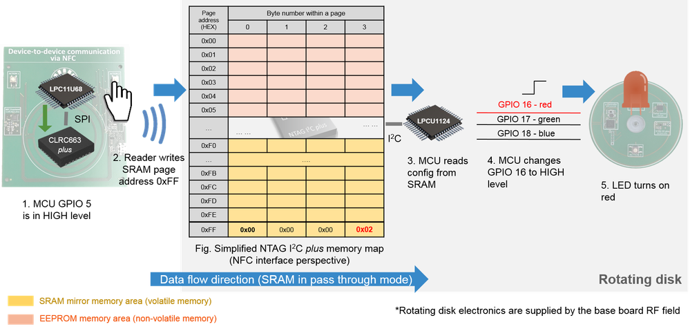

Reader module to rotating disk communication

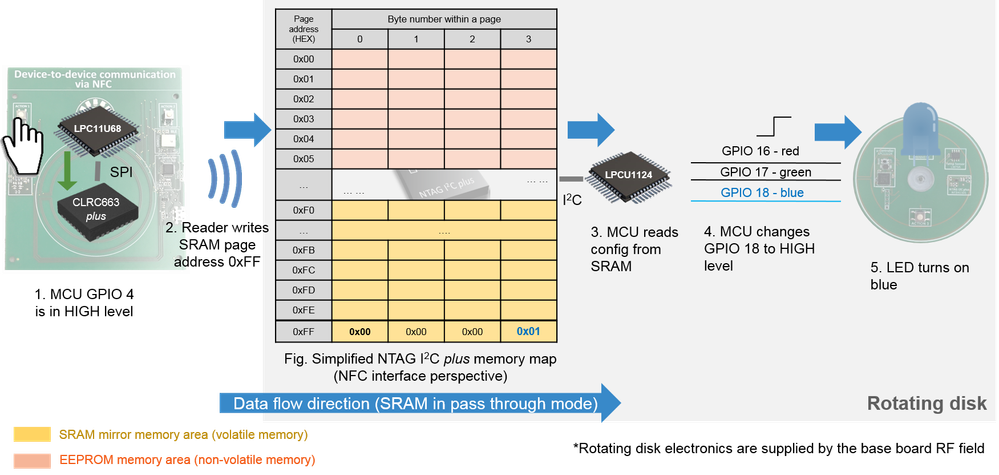

In this demo, the reader module sends data to the rotating disk when any of its two action buttons are pressed. The NTAG I2C plus is configured in pass-through mode and the SRAM memory is used as conduit between the twto units.  The figure below illustrates a simplified representation of NTAG I2C plus memory seen from the NFC perspective (organized in pages of 4 bytes each). The red area represents the EEPROM memory while the yellow one represents the SRAM memory location. While the button 1 is pressed:
  1. The GPIO 4 of the LPC11U68 is in high level.
  2. The CLRC663 plus writes one byte into the SRAM memory (last page, value = 0x01).
  3. The LPC11U24 on the rotating disk reads the SRAM.
  4. The LPC11U24 changes the GPIO 18 status to high level.
  5. The RGB LED turns blue.
The operation that takes place while button 2 is pressed is pretty similar. Basically, it changes: the data written by the CLRC663 plus in the SRAM and the GPIO activated by the LPC11U24 on the rotating disk. More precisely, the steps are:

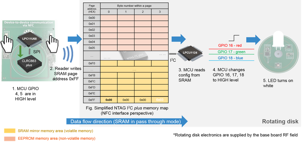

In the same way, while the two buttons are pressed at the same time:
  1. The LPC11U68 detects that GPIO 4 and 5 are in high level
  2. The CLRC663 plus programs a different value on the last SRAM byte (0x03).
  4. The LPC11U24 sets to high the three GPIOs (16,17,18) controlling the RGB LED.
  5. The RGB LED turns white

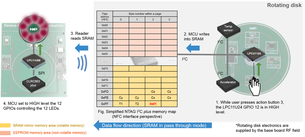

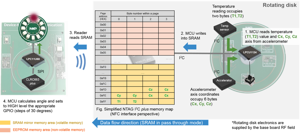

Rotating disk to reader module communication
In this demo, the rotating disk keeps sending data to the reader module for as long as it is powered by the RF field. Precisely, it continuously sends the disk position (via the accelerometer axis coordinates) and the measured temperature value. Additionally, an extra byte is sent while the button 3 is pressed. The actual steps are:
  1. First, the LPC11U24 MCU triggers a read operation to the temperature sensor and accelerometer. The temperaturre reading occupies 2 bytes while the accelerometer axis coordinates occupy 6 bytes. This data is transfered the LPC11U24 via the I2C shared bus.
  2. The LPC11U24 writes these 8 bytes into the SRAM in page addresses 0xFD, 0xFE and 0xFF (see the figure below).
  3. The CLRC663 plus reads the SRAM when the LPC11U24 has finished writing it.
  4. With the read information, the LPC11U68 base board MCU calculates the angle and sets the appropriate GPIO to high level. Since the LED circle contains 12 LEDs, the base board is able to represent position changes of 30 degrees (360º / 12 LEDs).

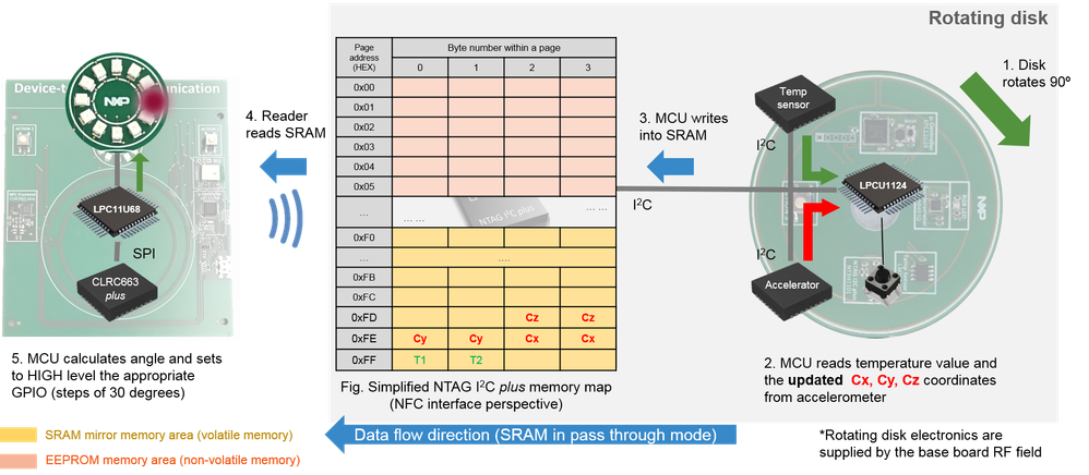

As mentioned, this data transfer keeps going for as long as the disk is powered. The key concept here is that the LED circle operation is directly controlled by the disk position and the axis coordinates which are exchanged via the NTAG I2C plus SRAM at any given moment. To illustrate this, the disk is rotated 90 º clockwise. The steps that take place are:
  1. The LPC11U24 MCU triggers the next reading command, the accelerometer axis coordinates have changed to different ones representing the new disk position (in red in the memory map figure below).
  2. The LPC11U24 writes into the SRAM again these 8 bytes (now with the updated accelerometer axis coordinates)
  4. With this new reading, the LPC11U68 MCU recalculates the angle and applies a different GPIO configuration (which leads to a different LED turned on in the circle).
Last, while button 3 is pressed:
  1. The LPC11U24 GPIO 12 is set to high value.
  2. The LPC11U24 checks GPIO 12 pin status before writing into the SRAM. While it is high level, it adds an additional byte into the SRAM (third byte on page 0xFF- value=0x01).
  3. The CLRC663 plus reads the SRAM, getting the latest data from the moving part.
  4. With the current firmware, while the third byte on page address 0xFF is set to 0x01, the LPC11U68 performs a LED pattern activating all the GPIOs simultaneously (all the LEDs are ON).

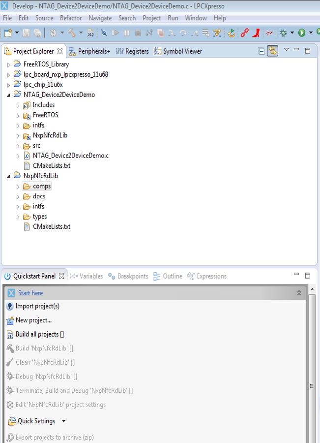

Reader module MCU code
The MCU firmware was developed using our LPCXpresso platform, which provides a complete development environment for LPC MCU and LPC boards. In the source code, there are five project folders:
  • The FreeRTOS project folder, which is an open source real-time operating system (RTOS) for embedded systems supporting many different architectures and compiler toolchains
  • The Lpc_chip_11u6x_lib and nxp_lpcxpresso_11u68b project folders, which belong to the LPCOpen libraries supporting the LPC11U68 MCU and PCB board, the MCU chip integrated in the Explorer board. If you use another MCU, you should replace them by the specific LPCOpen libraries.
  • The NTAG_Device2DeviceDemo  project folder, which implements the logic supporting the device-to-device communication demo for the reader module.
  • The NxpNfcRdLib project folder, which is the NXP's NFC Reader Library software stack supporting the implementation of the demo, the contactless protocols, the LPC MCU host interfaces and the CLRC663 drivers.

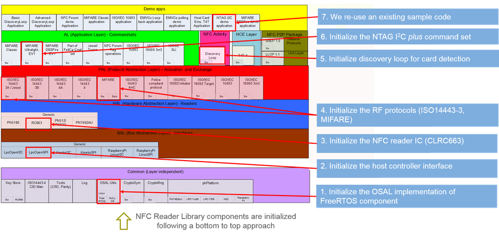

The reader module MCU code leverages on the NFC Reader Library. The NFC Reader Library is a software stack for creating and developing contactless applications for NXP's NFC readers. This API facilitates the most common operations required in NFC applications such as: reading or writing data into contactless cards, exchanging data with other NFC-enabled devices and emulating cards.
In order to use the NFC Reader Library, a stack of components has to be built up from the bottom to the top layer. Precisely, the application requirements define which modules need to be enabled and which do not. For the reader module firmware:
  • The FreeRTOS is used.
  • The SPI is used as host interface.
  • A CLRC663 plus reader IC is used.
  • And, communication with NTAG I2C plus is needed ( ISO14443 Type A card and NFC Forum Type 2 Tag compliant)
As a result, the software components that need to be enabled within the NFC Reader Library are depicted in the following picture:

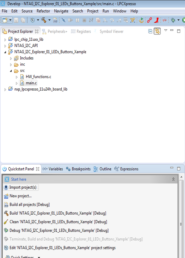

178607_178607.pngRotatingMCUCode.pngThe MCU firmware was also developed using the LPCXpresso platform.  In the source code, there are four project folders:
  • The Lpc_chip_11uxx_lib and nxp_lpcxpresso_11u24h_board_lib project folders belong to the LPCOpen libraries supporting the LPC11U24 MCU and PCB board, the MCU chip integrated in the Explorer board. If you use another MCU, you should replace them by the specific LPCOpen libraries.
  • The NTAG_I2C _API project folder is a library providing a set of functions and procedures that allow you to communicate with the NTAG I2C from the I2C interface. Among others, functions to perform memory operations on EEPROM, SRAM, registers and for enabling the pass through mode
  • The NTAG_I2C _Explorer_01_LEDs_ButtonXample project folder implements the logic for the rotating disk of this demo.

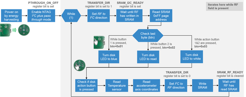

NTAG_I2C _Explorer_01_LEDs_ButtonXample application workflow
The rotating disk firmware starts its execution as soon as it harvests enough energy from the reader's module RF field. The first operation taken is to enable the pass-through mode. Then, the firmware stays on a loop for as long as it is energized.
In this loop, it sets the SRAM into RF to I2C direction (TRANSFER_DIR register bit) and waits until the base board has written data. After data has been written from the RF side, it reads the SRAM and checks the last byte:
  • While the last byte value is 0x01, it means the button 1 is pressed and the firmware sets the RGB LED to blue
  • While the last byte value is 0x02, it means the button 2 is pressed and the firmware sets the RGB LED to red
  • While the last byte value is 0x03, it means the button 1 and 2 are pressed and the firmware sets the RGB LED to white.
After receiving data from the base board, it prepares to send data back. For that: it checks the button status, it reads the temperature value and the accelerometer position. Once all the data has been collected:
  • It changes the SRAM to I2C to RF direction (TRANSFER_DIR register bit).
  • It writes into the SRAM and waits until the RF has read the data (SRAM_RF_READY register is cleared).
This loop is repeated for as long as the disk is powered. The following figure depicts the rotating disk application workflow in detail:
