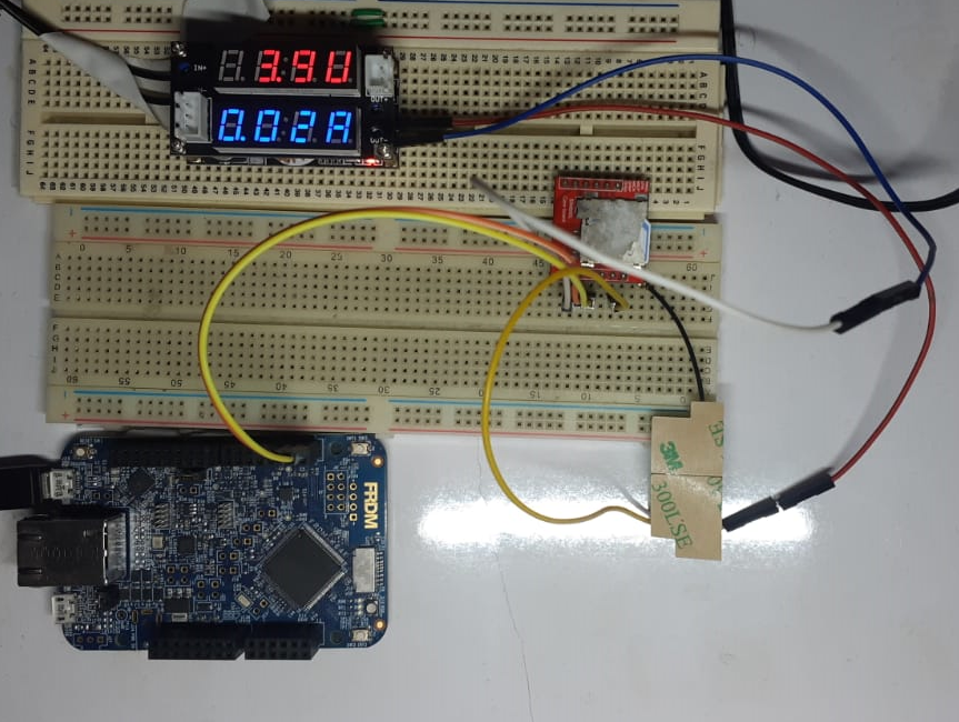

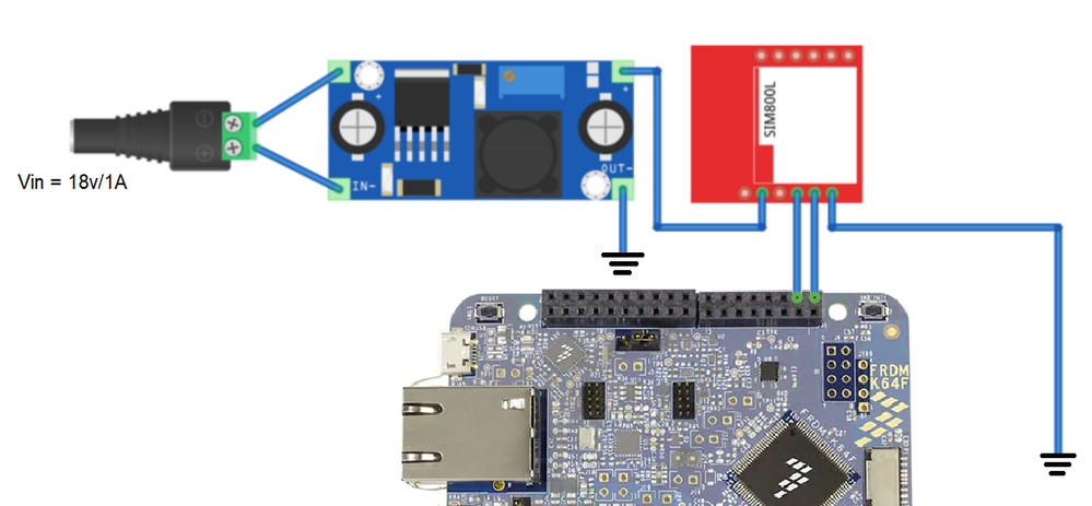

Hardware Diagram
  • Due to the SIM800 module's high current consumption, powering it requires a buck converter that is capable of delivering a current larger than 2 Amps while the module is sending a message. This is when the module consumes the highest current.
   SIM 800L  ===>    FRDM K64
        VCC    ===>    3V9 Buck Converter
          RX     ===>    TX (PTC17/J1-4)
          TX     ===>    RX (PTC16/J1-2)
       GND    ===>    GND

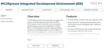

  2. Get the latest version of MCUXpresso using this link: https://www.nxp.com/design/software/development-software/mcuxpresso-software-and-tools-/mcuxpresso-i...

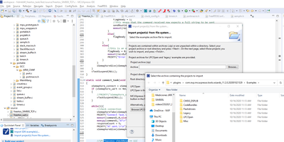

  4. Install the K64 SDK in MCUXpresso.
  5. Import the attached project in this document.
Attachments are found at the bottom of this document.
