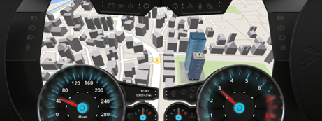

Screen shot 1: Cluster with 3D maps
Real-Time 3D map (created in Blender):
  • 640 abstract buildings.
  • 20 different building types.
  • 3 “special” buildings.
  • One building type.
  • 5x5 map grid.
  • Dynamic, directional lighting.
  • Calculating and updating car chase camera every frame.
  • Smooth 3D animations even at 30 Hz.
  • This is no video!
Screen shot 2: Secondary Display playing Video or RearView Camera
