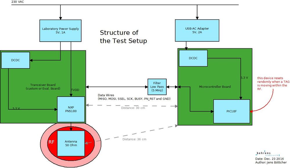

hello community,
i have a problem to use the PN5180. the situation is that i have developed a custom board with a microcontroller, the PN5180 and a pcb-antenna. when i put it into operation the microcontroller resets several times. my first guess was an influence of the electromagnetic field. so i put the different parts in spatially separated locations. the microcontroller gets his own supply and the tranceiver with antenna gets his own supply too. only the data signals (MISO, MOSI, SCK, NSS, BUSY and RESET) and GND are connected from the microcontroller to the tranceiver. to avoid conducted faults every line gets a 5 MHz low pass filter and the GND between filter and tranceiver gets a choke. the SPI speed is 1 Mbps. the filter works fine.
the antenne has a distance of 36 cm and the tranceiver of 30 cm to the microcontroller.
when i read and write registers or the eeprom everything is fine, but when i take the field on the microcontroller restarts. the field strength is on the lowest power level, i only use one gear. after a couple of restarts the microcontroller starts the provided operation. the actual operation is to read out the uid of ISO15693 and ISO14443A transponders and send it over a com port (UART) to the pc. but when the provided operation is active and i put a transponder in the field, the controller begins to restart again. in other applications with tranceiver-chips of other manufacturer the microcontroller works fine, even in the middle of the pcb-antenna. the problem only exist with a matched antenna nearly 50 ohm. with other antennas (i tried a 400 ohm antenna for example) theres no restart but with this antenna the tranceiver couldn't read out a transponder. the same result with no antenna connected. there's no considerable field strength measurable close to the microcontroller in the spatially separated setup. i try the same with the evaluation board (PNEV5180B V2.0) an the supplied antenna instead of my tranceiver board and antenna, but the same result.
when i put another matched antenna close to the antenna of the tranceiver the microcontroller stops to restart but in this situation i can't read transponders too.
my own suspicion is, that the tranceiver trys to get to much power over the data lines and so the maximum current of the supported current of the microcontroller is exceeded. is there a similar case known?
at the moment i do not know what to change that the test setup works.

jensboettcher
hello leonhard,
no, i can't observe a restart of the uC when i only switch on the RF field.
on my custom board is a 100nF ceramic capacitor directly on the TVDD pin. on the eval. board is a cascade of 100uF + 100nF in series to a 22nH choke and a second cascade of some uF (i cant' read it on the schematic of the board [AN11741]) + 100nF. until now I have assumed that the eval. board has a workable equipment. in the test setup the TVDD is directly driven from the laboratory power supply (in this case a Manson HCS-3302 switching mode supply, 1-30 VDC, up to 15 A) wich is limited to 1A. the supply voltage is 5 VDC. the typical current flowing through TVDD is <= 1mA when RF is off and 190mA when RF is on.
The uC is driven with a USB-AC Adapter (5V, 2A), so that the spikes on TVDD should not influence the power supply of the uC. for the future use it is scheduled that the whole board is driven with a USB-AC Adapter or a USB Port that support 1A or more.
i try to draw the situation in a block diagram:
thanks for help and merry christmas
jens boettcher
