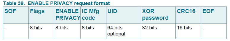

SLIX-S PRIVACY PROTECTION PASSWORD IS ERRO, I HAVE TRIED SAME LIKE SLI-S.
CAN YOU TELL ME WHAT IS THE RIGHT PROCEDURE OF PRIVACY PROTECTION PASSWORD.
1,195 Views
Jonathan_Iglesias
With SLI-S we need to set password first, with the -S and -L you have to send the password within the command itself – ENABLE PRIVACY - BAh(as with the SLIX 2). See datasheet.
  • All password bytes are 00h for the read and write protection password and the
    EAS/AFI password.
  •  All password bytes are 0Fh for the Privacy and Destroy passwords(Section 8.2.2 datasheet)
