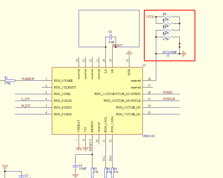

dear sir
   i encounter a question about test the battery voltage with the ADC function .
  1. my schematic diagram is below
2 my source about test the vcc voltage code is below
static uint16_t Get_current_adc(void)
//int adc_max=0xfff;
int adcInput=0;
int total_adc=0;
//! [adcdac_nss_example_3]
Chip_IOCON_SetPinConfig(NSS_IOCON, IOCON_ANA0_4, IOCON_FUNC_1);
Chip_ADCDAC_Init(NSS_ADCDAC0);
Chip_ADCDAC_SetMuxADC(NSS_ADCDAC0, ADCDAC_IO_ANA0_4);
Chip_ADCDAC_SetInputRangeADC(NSS_ADCDAC0, ADCDAC_INPUTRANGE_WIDE);
Chip_ADCDAC_SetModeADC(NSS_ADCDAC0, ADCDAC_CONTINUOUS);
Chip_ADCDAC_StartADC(NSS_ADCDAC0);
int max,min;
total_adc=max=min=0;
for(int i=0;i<10;i++)
adcInput = Chip_ADCDAC_GetValueADC(NSS_ADCDAC0);
total_adc+=adcInput;
if(max<adcInput)
max=adcInput;
else if(min>adcInput)
min=adcInput;
Chip_ADCDAC_StopADC(NSS_ADCDAC0);
total_adc=total_adc-max-min;
//get the average value
total_adc=total_adc/8;
//get the caculate from https://community.nxp.com/message/1119718#comment-1120963
//output in mV = ((native value - native offset) * internal operating voltage / steps per uV) + offset
//native offset=2048,internal voltage = 1.2V,gain (steps per uV) = 2730,offset = 0.9V
adcInput=(total_adc-2048)*1200/2730+900;// get the test point voltage ,unit is mv
//convert the test point voltage to VCC voltage
adcInput=adcInput*5/2;
return (uint16_t)adcInput;
/* Further handling of the threshold breach. */

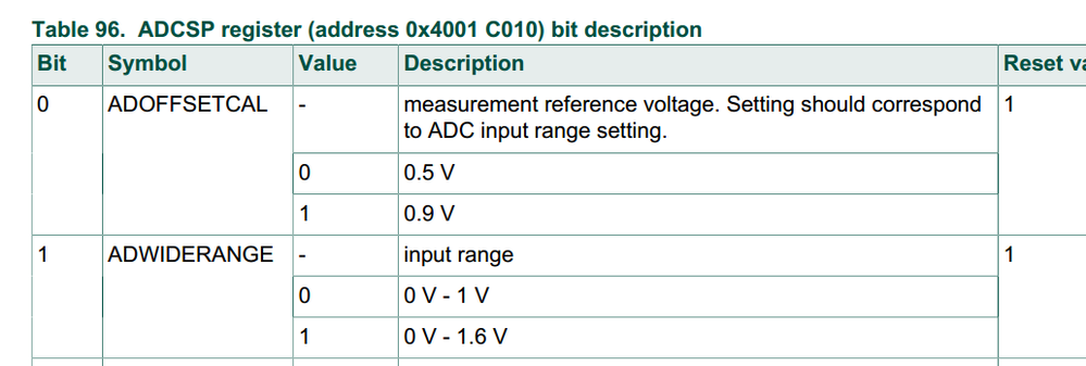

my question is :
  • how can i get these value ?i get from this value in another question ,but i do not no why ?i can not find it in spec ...native offset=2048,internal voltage = 1.2V,gain (steps per uV) = 2730,offset = 0.9V
  • my ADC value adcInput  change rapidly,it is not a stable value ,
for example ,i get the voltage VCC by multimeter is 3.0V
but ,i tried 10 times test the value ,and get the adcInput = Chip_ADCDAC_GetValueADC(NSS_ADCDAC0);read from the register is below .
Header 1Header 1Header 2Header 3Header 4Header 5Header 6Header 7Header 8Header 9
adcInput(mv) 269526772573259625782676259726702630
VCC(mv)296029412826285228322940285329332889
can you give me some advise ?is there anything wrong with my schematic ?
is there anything wrong with my design formula ?

It's a bit confusing to use a NHS3100 symbol in your schematics. - a good thing the digital pins are identical to the NHS3152 :-)
When the debug connector is still attached, a lot of noise is injected. Is it possible you measured those numbers within a debug session? If so, can you repeat your measurements without a debug session and without the LPC-Link2 debugger board connected to the NHS3152 IC?
Your fitting parameters used in the formula adcInput=(total_adc-2048)*1200/2730+900 do not ring a bell for me. Can you try to recall how/when/where you received those?
After the weekend, I will try and see if I can find other fitting parameters - we surely must have done this before, I need to check if I can find a trace of that somewhere...

i am sorry that i make a mistake in the schematic ,i use 3152 not 3100 in my test .
  1. the data ADC value that i test is not in debug mode without LPC-LIN2,i use CR2032 instead .
  2. is there anything wrong in my bleeder circuit ?
  3. the formula adcInput=(total_adc-2048)*1200/2730+900
i get the formula from https://community.nxp.com/message/1119718#comment-1120963 this document that you replied before

The formula given was derived from an early sample, and does not accurately reflect the state of the released ICs.
This formula provides a better conversion for production ICs:
adc_input_voltage = (native_value * 1.2V) / 2825 + 0.09V
(Of course, for your schematics, you need to retain your multiplier 2.5 as well).

i am sorry to trouble you again !
first :
i still confused about the formula  you offered before ,how do you get the formula ?
how to use reference voltage /  ADC resolution 12 bit and input range get the formula ?
second :
i have another question about ADC like before ,my schematic is still the picture like before ,i get the ADC raw  value from the register now ,and calculate the value average about 10 times .but there is still  about  15 --20 raw data fluctuation . i have no idea how to deal with the  fluctuation ,can you give me some advise ?

Could you please explain how this formula was derived from the NHS3152 datasheets since I believe it should be as follows
adcInput = ((float)Chip_ADCDAC_GetValueADC(NSS_ADCDAC0) *
1600) / 4096;

The ADC is not linear at the extremities, causing a slightly steeper slope of the conversion from raw to voltage. The formula takes this into account.
2
A 20 raw data fluctuation corresponds to ~8.5 mV, which is not that much. There is noise on the voltage input, and the IC being active also causes small fluctuations. You can use a scope to measure more precisely the voltage, as a multimeter is only showing averages. Perhaps best is to configure the scope in AC-coupled input mode to measure the ripple on the battery directly. You can also bring out a signal to synchronize the scope measurements with the ADC conversions.
