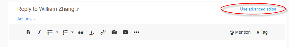

Hi William,
Could you see "Use advanced editor" option as below? You may use it to attach the log, or directly send it to me via the private ticket you created in SDFC.
Thanks for your patience!
Kan
