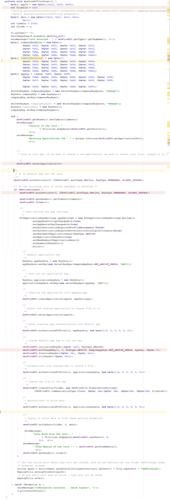

After i changed the application default key to our custom key, when i write data to file, it is throwing an error "Invalid length".
find below is the full code.
Here the line, i am getting exception
#java  desFireEV2.writeData(fileNo, 0, data);java‌
Please let me know did i miss anything.
Thanks, Shiva 2017-11-22_11-29-39.png java

Looks like you set the number of byte written to 0 in "desFireEV2.writeData(fileNo, 0, data);"
Kan
