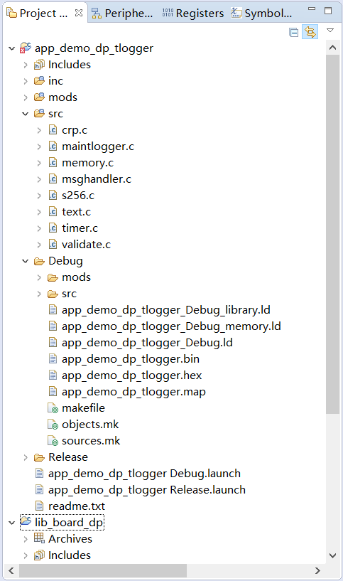

    I am using the NHS3100 Temperature Logger Demo, but when i add my own code in the demo program, the code size is over the flash size(30K), and the compile error is `.text' will not fit in region `Flash30'(as below).
I also checked the ".ld" file and the detial memory config is below:
I know that the flash size is only 30k to use, and a part of flash memory used to store the  temperature data, therefor, how can i solve the problem and reduce the memory size for storing the temperature data and increase the memory for code using.
      thanks!

I assume you are still developing your code, and you want to free up some space while still using the Debug build configuration?
The project is a 'managed project' within the LPCXpresso IDE, which means that the makefiles will be generated for you. After building, you can find the generated makefiles within the Debug or the Release folders.
If not done already: select your project, then go to Project > Properties > C/C++ Build > Settings > Tool Settings > MCU C Compiler > Optimization. Check the selected build configuration above, and set the Optimization level for Debug to -Og.
Other gains can be made by linking the release build of the chip and the board library to your debug build of the application, or by selectively changing build optimizations for specific C files - not advised. Switching at project level to -Og is by far the easiest way, which gives quite a benefit while still allowing you to debug your code easily.

long19890829
Hi Dries,
Thanks for your reply, and my problem has been solved based on your advise. BTW, did you know the NHS3100 could support the Flash-Read and Write protcetion function, I would like to put the prive key into the special flash region for the security purpose.How can I achieve this, did you have any details, Thanks again!

long19890829
Or anyone can tell me how to set the .text  sections size, and I can not find any link file in my project.  Thank your very much!!!
