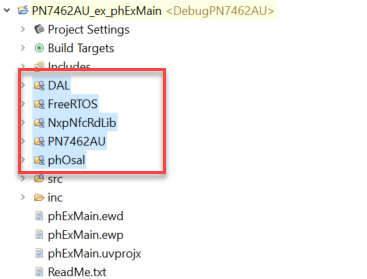

I tried building code for PN7462 and it shows below error?
How to resolve it. Attached is code.

Hello @deepakbansal ,
Looks like you just imported "PN7462AU_ex_phExMain" into your workspace, actually there are several reference projects needed imported as well, please kindly refer to the following for details.
Hope that helps,
