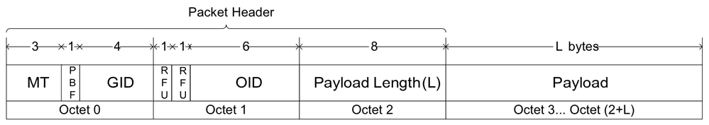

dominusdrr
I answer to myself.
The response frame must satisfy the following:
187574837-ae0bb874-a024-4b43-a350-b48b280ec24f
So in the payload (which is 3 bytes) there would be the Status, NCI Version and Configuration Status

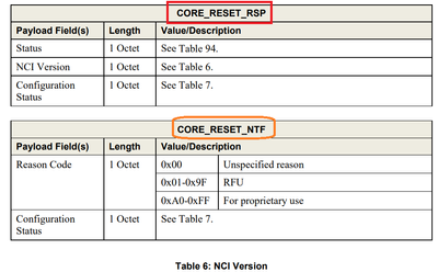

dominusdrr
I answer myself, in this table is what is answered to that command, and it is 3 bytes (RSP) and 2 bytes (NTF), I still have to verify what values it really returns

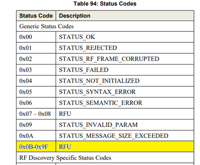

dominusdrr
Again I answer to myself.
The response from the NFC has been exactly the one that generates an error in the Arduino example code in the OP. (0x40, 0x00 and 0x03)
The first byte, which is 0x40, is supposed to be looked up in table 94, but there is no code status value.
The same happens for the second and third byte. These values don't indicate the possible cause of the problem

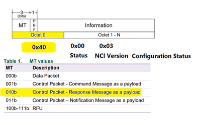

dominusdrr
I answer to myself.
It seems that I just understood
I think that 0x40 is the header of the frame, it indicates a response to a command sent from the DH (microcontroller)
