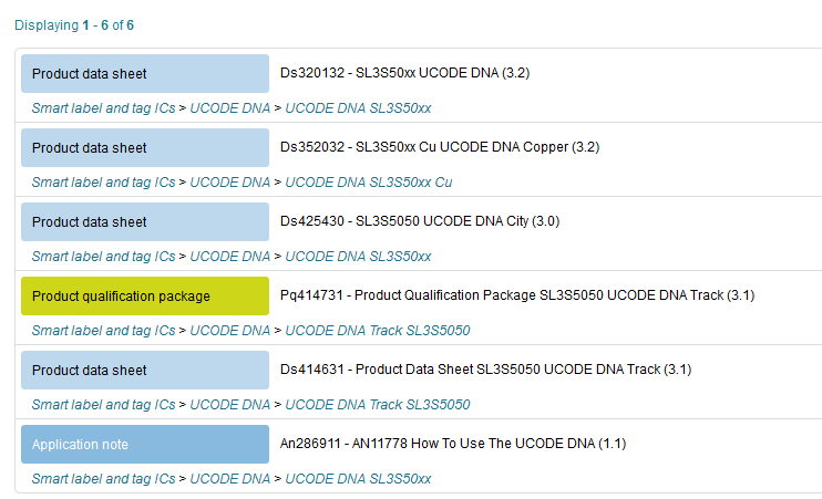

1. What is the chip impedance information for UCode DNA?
- This info is under NDA, and you have to request it from the docstore. Please refer to the attachment for more details.
2. Is the chip impedance of UCode DNA similar to (or the same as) UCode 7?
-Yes the impedance is similar – not exactly the same.
3. Can I design an antenna based on the chip impedance information of Ucode 7, and so the antenna can work for both Ucode 7 and UCode DNA?
-Maybe some fine tuning needed but the answer is yes. Antennas will work for both .
