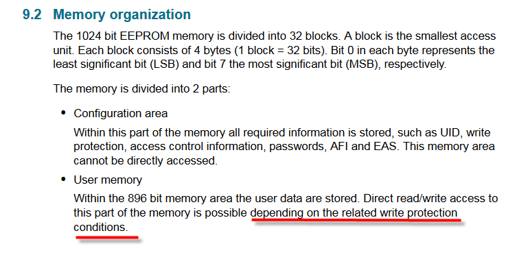

Hi Amir,
I think maybe some position in the user memory is protected so you can not write 112 byte in on time. Please kindly refer to the following snapshot from the data sheet.
Hope that helps,
Kan

Hi Kan,
thanks a lot for your answer. Anyway, the user memory is not protected. I can write the data to the Siemens tag MDS D100 (with NXP ICODE SLI chip inside) with some Siemens industrial RFID Readers like RF340R. I can also write the Ndef data with the Android App NFC Tools PRO with my smartphone Samsung S7 to this tag. The exception appears when transceive() is used for the first time with write single block (0x21). The same software works with some other RFID chips like Fujitsu MB89R118 or TI TAGIT HFI. Transceive() with read single block (0x20) or GetSystemInfo (0x2B) works with all chips. I tried also to wait a little bit (100 ms or even 1 second) before transceive() with write single block is executed, but with no success.
My Software is like:
