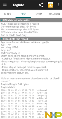

Luke67
I can copy the .csv excel to my mobile, open the .csv with a text editor, copy paste every company to a textfield tag in tagwriter and write it to a company card but that takes a lot of time.
Is there a fix for import the .csv textfield with linefeeds in a textfieldtag (for every excel row a new textfieldtag in tagwriter)

nxf58474
We do not have information about any update in the TagWriter app. But, this other tool might be a solution for you, the TagXplorer PC based NFC Tag reader-writer tool.
With this tool, you can write NDEF's to your tags, I have tested with one of your "examples", and it writes it correctly.
