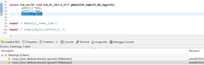

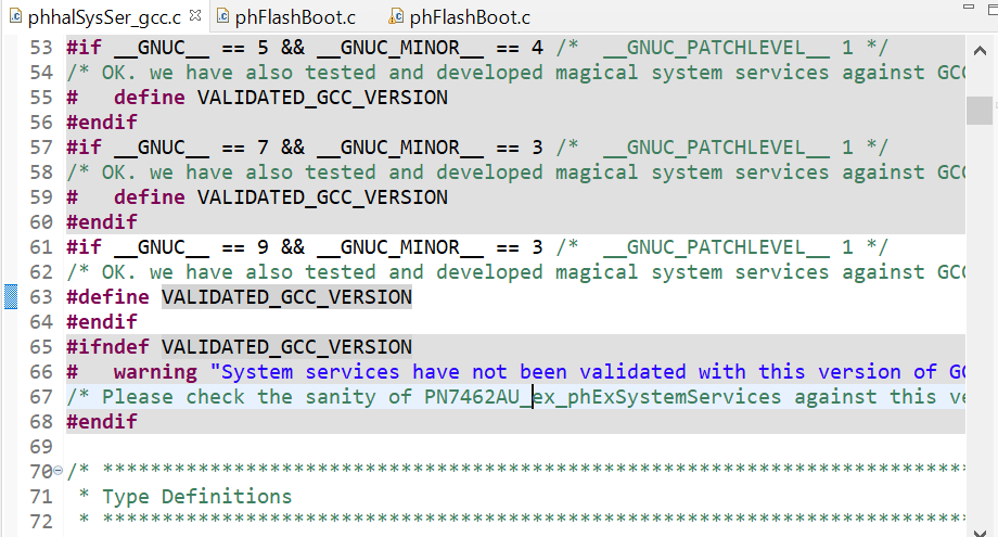

We are getting few warnings while building code for PN7462 kit. and software version PN7462AUPspPackageFull-v05_22_01.
1.. "System services have not been validated with this version of GCC"
Is this warning critical and should be corrected or can be ignored?  I tried updating MCUxpresso its latest version : MCUXpresso IDE v11.3.0 [Build 5222] [2021-01-11]

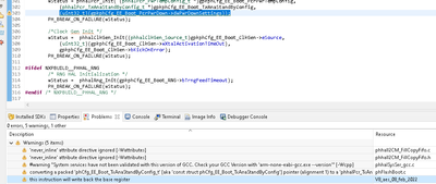

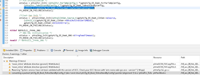

2. Here are screenshot of all the warnings

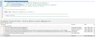

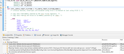

3. When i clicked on each warning it took to source code:
4. What is this "Info" ?

Hi @db_1017 ,
- It is not critical, and you may just ignore it or update the source file as below:

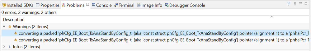

and from my side, I just see two warnings, and my IDE is MCUXpresso IDE v11.3.0 [Build 5222] [2021-01-11], is it the same with you?
Basically they are not critical either. The demos are validated before release.
