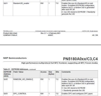

Hello, I have some questions about PN5180 datasheets.
In section 11.5.2 EEPROM (Table 51.), address [0x51] and [0x58] have same descriptions.
I'm little confused. Should I use both or what? or is it some typo?
And what's the difference data sheet suffix "_C3_C4" and "-C1-C2"
Is "PN5180A0XX-C1-C2.pdf" document just older version of "PN5180A0XX_C3_C4.pdf" ?

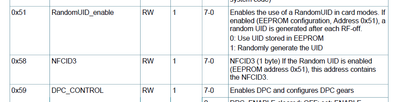

FYI, I attach some part of EEPROM address table from "PN5180A0XX-C1-C2.pdf".
As you can see, it's from first image.
Thanks, and have a good day.

 The 0x51 is the value to activate the RandomID and the 0x58 stores the UID03.
And the difference of the C1/C2 and C3 version is Firmware version. Please refer to the datasheet for the detail information.
Hope it help you. Have a nice day.
