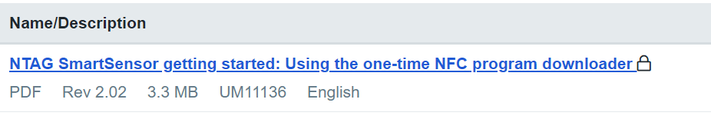

15,133件の閲覧回数
Kan_Li
Hi @leo94 ,
We provide any app note on this topic, please kindly refer to https://www.nxp.com/webapp/Download?colCode=UM11136&appType=license for details.
Hope that helps,
Kan
