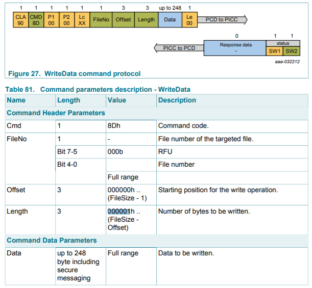

I am trying to use the NTAG 424 chip for my anti-tamper application. For this I implemented the AES authentication and cryptographie for sending and receiving commands.
However when I am trying to issue the writeData command with some dummy data, I get the error: 917E: "Length Error"".
The data I am trying to send is the following
cmd_header = 02000000040000
cmd_data = 00D1FF00 (before padding)
cmd_data = 00D1FF00800000000000000000000000 (after padding)
now the complete command which I send looks like this:
cla cmd P1&2| Lc |ISO Header          | encrypted Data |
90 8D 00 00    1F 02 000000 040000 6688A4D75482FC972C2447A1A20F0AC9C073C1CF506B2BD3 00
I dont think that I made errors in the encryption, because I implemented a unit test which replicates the results of the example in the AN12196 application note (Table 17). Also, the PICC returns an Length error, which according to the Documentation means "Command size not allow". I do not understand this error, but I dont think it has something to do with my encryption.
So does anyone know what I am doing wrong?
Phil
Update: So I can definitely say that the fault has nothing to do with my encryption, because I can correctly parse the response from the chips for commands like the GetTTStatus and the GetCardUID. Additionally I can correctly encrypt and send the SetConfiguration command, which tells me that I definitly send the correct command.

you are right if we are in plain mode. If we are in plain mode, and I want to write the bytes (6688A4D75482FC972C2447A1A20F0AC9C073C1CF506B2BD3), then I have to have a length of 24 in my header.
If, however, I want to write the 4 bytes as specified in my question (in encrypted communication mode), then it does not work to put a length of 24 (18h) in the header.
So my workaround for the moment is to write the 4 bytes in plain communciation mode (in which I dont have to perform the encryption) and then to lock the file with the desired key.
However I would like to know how to write in encrypted mode? The Data-sheet is a bit unspecific in this term, and the application note is just plainly wrong (the application note has also a couple of other errors see for example)

Please check this process, this is the entire process I used, please check that you have changed the file settings so it supports encrypted communication and which keys are allowed to perform this actions. and check the LC of the APDU command.

I believe the problem is thar the lenght inside the CMD header is incorrectly please  check datasheet Figure 27
the number of bytes to be written  should be 24 bytes  (6688A4D75482FC972C2447A1A20F0AC9C073C1CF506B2BD3)
