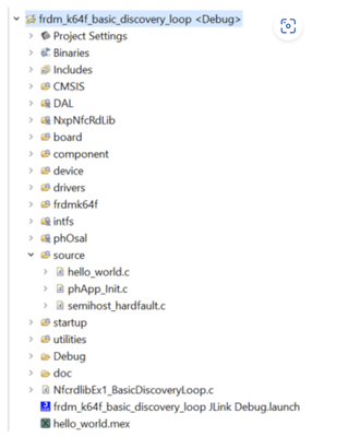

The process described in the NFC Reader Library Porting FRDM_K64F, describes that after linking the DAL, phOsal and infs directories, they should appear in the project folder like this..

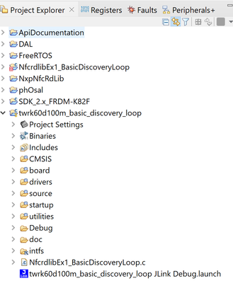

but they don't. My project folder looks like this..
The infs directory is there, but the DAL, NxpNfcRdLib and phOsal do not appear to be there. BUT I know they are there - they are just "hidden".
Is there a way to display the hidden folders..?

The issue is more of the DAL directory seems to be in the correct place (after linking) but when looking at the project explorer, is only displayed in the workspace and not under the project itself.
It is as though it is "hidden"...
Is there a way to display "hidden" directories.
