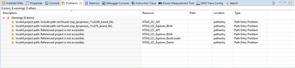

I downloaded the "Explorer Board firmware C Source Files" SW3647 from Nxp website.
I imported the example files in a new MCUxpresso workspace following the UM10945 instructions.
Before to compile I already have the warnings attached.
The projects "nxp_lpcxpresso_11u324h_board_lib" and "nxp_lpcxpresso_11u37h_board_lib" there isn't in the example.
What I have to do to solve this warnings?

Dear luca.securo@bwtdyn.com,
I have confirmed that this library was created by a third party company, so we will have to wait for the next release to get a fix on this, as far as I have tested this warnings have no problem to work with the library, I think that you can work with this warnings pretty well.
Jonathan
