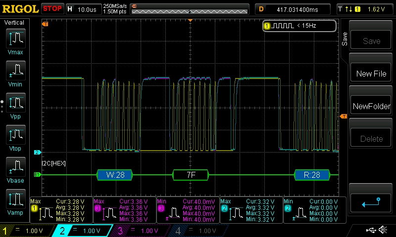

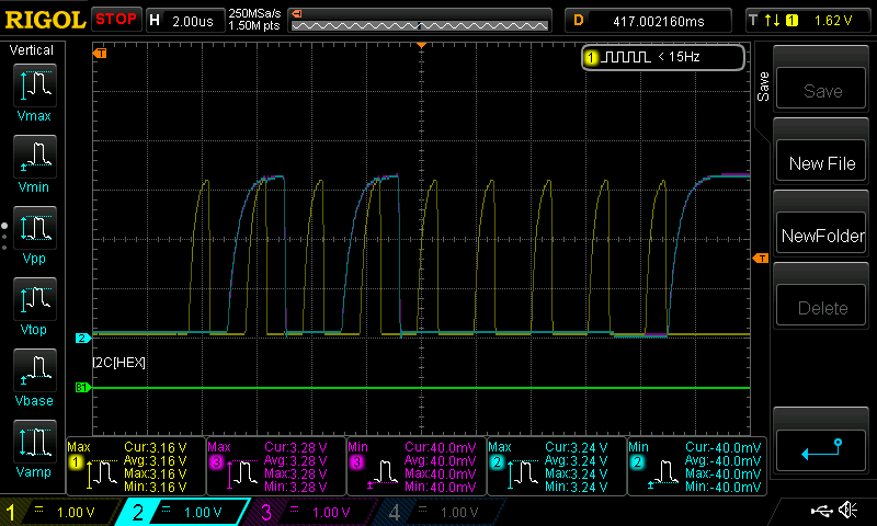

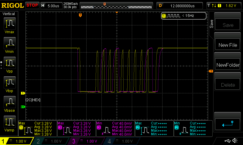

Below are some scope images showing the issue (ACK not send) and the same images when ACK is sent when the IC is warmed up. Scope channel 1 (yellow, CLK) and 2 (Cyan, SDA) show the I2C signals near the MCU. Channel 3 shows the SDA line at the MFRC630 to see if it differs from the signal at the MCU.
No ACK after sending the address. (Channel 1 = CLK (Yellow) at MCU, 2 = SDA (cyan) at MCU, 3 = SDA at MFRC630)
No ACK after sending the address. same image showing only SDA at MFRC630.
ACK received after sending the address (and following read data). (Channel 1 = CLK (Yellow) at MCU, 2 = SDA (cyan) at MCU, 3 = SDA at MFRC630)
(Zoom in on above picture showing 8 bits + ACK/NACK) ACK received. (Channel 1 = CLK (Yellow) at MCU, 2 = SDA (cyan) at MCU, 3 = SDA at MFRC630)
Same sample only showing the SDA line on the MFRC.
