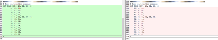

danielchen
Hi @iwannugraha
I compared the configuration file, one difference. please see below picture
Left is yours, right is the default settings. Can you modify the '01' to '00'  and try it again?  this bit related to supported bitrate.

iwannugraha
Hi @danielchen ,
I've tried it, but still can't detect type b card
