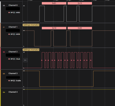

  • It would still be very helpful if you could please send a picture of the UART pins showing the communication frame with a logic analyzer.
    logic_analyser.jpg picture is attached
    yellow line represent RX to the CLRC
    green line represent TX of the CLRC

Please share a picture of the communication frame in which the configuration of the oscilloscope or logic analyzer allows to interpret the commands sent and the response can be appreciated.  Something similar to this but for the UART interface:

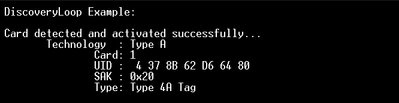

When using the SPI interface previously did you get the expected log?
Are you able to observe this log when using the UART interface?
