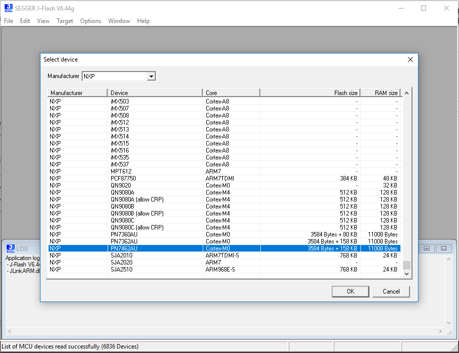

Hi All,
I'm using a PN7362 and I'd like to perform a flash programming via SWD (with LPCXpresso) without the IDE MCUXpresso but with a simple Software like Flash Magic. Unfortunately I'm not able to perform the programming with Flash Magic because doesn't support PN7XXX family. Is available unother PC software?
Thank you

thank you Kan Li for the reply.
I'd like to perform the programming with LPC-Link 2, Is there another PC Software avalilable?

Kan_Li
LPC-Link 2 can be used as a jlink, please refer to LPCScrypt v2.1.0 | NXP for details.
Hope that helps,
Kan
2,262件の閲覧回数
Kan_Li
You may try jlink instead. Please refer to the following for details.
Kan
