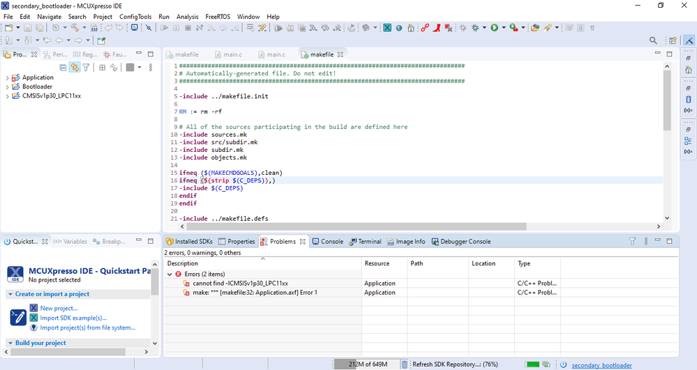

3,884件の閲覧回数
shiv_patil
Hello @Kan_Li
I am referring to the N10995.
I have imported the secondary bootloader examples to the MCU Expresso.
Built the projects.
I am able to build the bootloader & CMSISv1p30_LPC11xx.
But,
While Building the application project, I am getting the following error.
Note: I haven't made any single change to the application project.
Will you please help me to debug this error?
Shiv Patil.

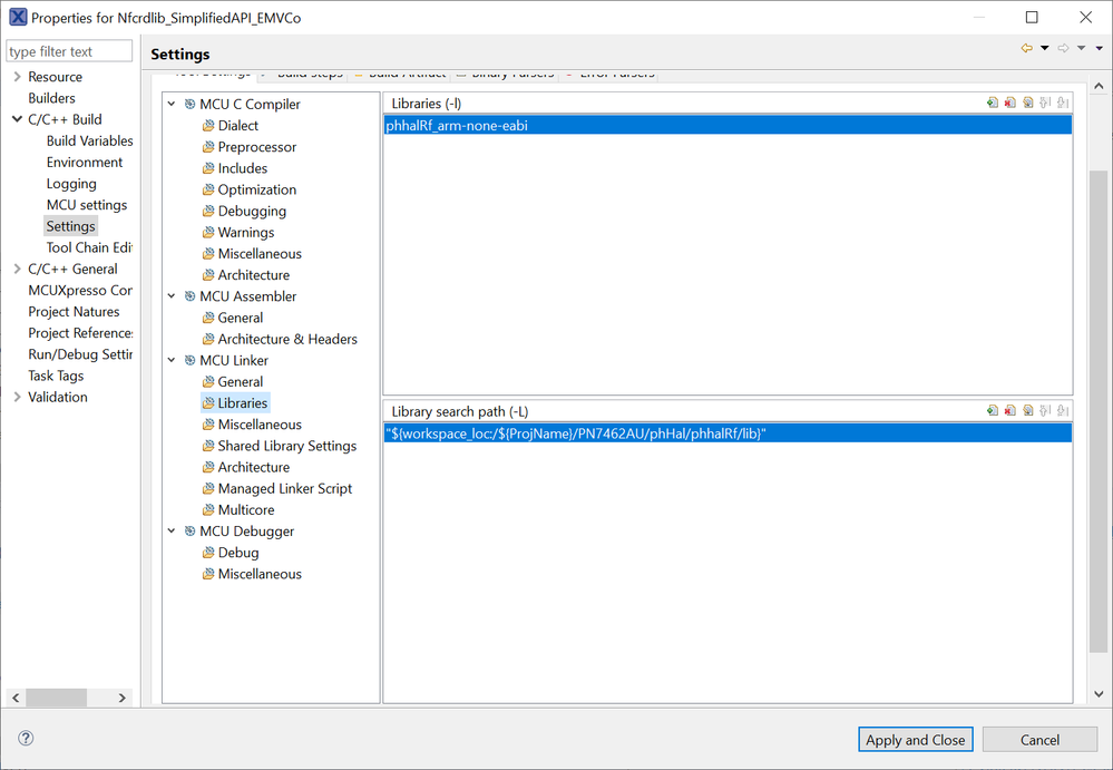

3,870件の閲覧回数
Kan_Li
Hi @shiv_patil ,
Actually I am not expertise with MCUXpresso IDE, but referring to the snapshot, looks like there is some lib missing, please kindly check the path settings something like below:
Kan
3,867件の閲覧回数
shiv_patil
Hello @Kan_Li ,
By setting the build configuration to release mode. I am able to solve this problem.
