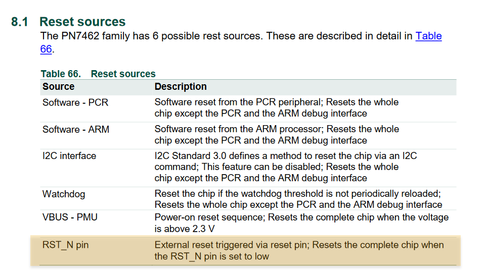

when RST_N input is active (low) the PVDD_OUT does not reach 3.3V
Pls see attached observations with scope dumps.
What is preventing the PVDD_OUT startup when RST_N is active ?
Why is the RST_N input pin not listed in the PN7462 family datasheet rev. 4.3, 24 January 2019, chap 8.16.1 table 25 ?

stephanie_m
You can check the chapter 8.1 of this document, I believe you will find useful information.

vijo
thank you,
but why is PVDD_OUT does not reaching 3.3V when the RST_N pin is low ?

stephanie_m
Please consider that there are some configurations that might be affected during a reset, also, you will need to make sure that there must not be any load current drawn from PVDD_LDO during the soft start of the PVDD_LDO and consider that the PVDD_OUT it's an output of PVDD_LDO for pad voltage supply as it is mentioned in the data sheet of the device.

vijo
Thank you.
In stead of a reset IC I used a pull-up to VBUS like on the evaluation board.
And it works well.
