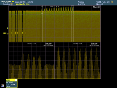

We would like to add a HCE mode to one of our PN7462 reader boards. Because the underlying schematic does not have the ANT-pins attached to the antenna we would like to use the Active Load Modulation-Feature (ALM) of the chip.
For a simple test I placed a CLRC663 eval board above the PN7462 reader board. In-between both devices I put a pickup coil and connected it to an oscilloscope. Both devices were set to be used with the NXP NFC Cockpit (thus a total of 2 Cockpits were running on my PC). Hereby the CLRC663 was used as a reader and the PN7462 was used as a HCE device. Using the PN7462-NFC Cockpit the ALM mode could be activated and the board did a very strong "simulated" load modulation when communicating with the CLRC663-NFC Cockpit. Below the output of the pickup-coil can be seen:
Moreover, all the ALM settings were accordingly written to the PN7462's EEPROM:

I expected that the PN7462 could now be flashed with a sample project, e.g., PN7462AU_ex_phExRf_mcux with only the CM active. Please note that exactly this PN7462 was previously configured to ALM mode using the Cockpit whereas the EEPROM contents was not altered.
While debugging the PN7462 I can see the firmware run to the wStatus = phhalRf_AutoColl(... line in phExRf_CM.c. Accoding to UM10913 Chap 4.10.4 "The AutoColl function takes care of configuring the base rates for all the supported technologies.", so no need to do an Load-Protocol. However, there is no visible ALM on the oscilloscope. Also, when I read the CLIF_TX_CONTROL_REG one line after the phhalRf_AutoColl command it is 0x00, i.e., the TX_ALM_ENABLE bit is 0.
When I flash the Cockpit FW to the PN7462 and start the Cockpit, all ALM settings can be restored and the "Start Cardmode" button also restores the ALM mode.

after further investigation I found out that phhalRf_AutoColl(..) seems to set the register CLIF_ANA_TEST_REG to a value of 0x0150004A. When I set it back to it's reset value 0x50004A using a debugger, phhalRf_AutoColl(..) terminates. Also the ALM starts working then and I can see a strong ISO14443A-106 load modulation.
So what is this 24'th bit that seems to block communication? Is it a good idea to set CLIF_ANA_TEST_REG to it's reset value, e.g., after phhalRf_AutoColl(..) was started?
