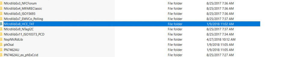

Hi all,
Using the OM27462CDKP (the PN7462 eval board) I'm trying to emulate a ntag213, and I wanted to start with the PN7462AU_ex_phExMain code to help me get a hang of how to set that up. The quick start guide it merely says change the APP-NxpBuild.h to get the example you want, but no matter what I change the program does not seem to care.
Can anyone either A) help me get that example working, or B) provide some example code to emulate a card?
Nick

Dear Nick Hansen,
Hope you are doing great, there is already an example in the library that emulates a type 4 tag, I am not sure if you strongly need it to emulate a T2T but  what this example does is to put the PN7462 in Host card emulation (NfcrdlibEx8_HCE_T4T)  and  waits for a reader to activate it and read an NDEF from the reader the NDA its an URL to the webpage of NXP. please check this and let me know if  it works for you.
Jonathan

Jonathan_Iglesias
Dear Nick Hansen,
My apologies for the delay, I am referring to the example 8 NFC Reader Library | NXP , please check this example there is no need to modification you can debug it and check that it automatically puts the reader in HCE mode and interacts with readers as a T4T. please check this if you have any questions please let me know.pastedImage_2.png
Have a great day !
