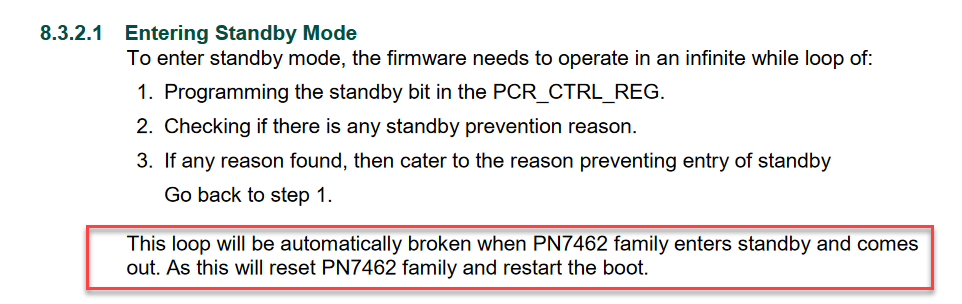

stephanie_m
Could you please help me check the following UM ? If you check the UM10858 there are more details of the power modes on chapter 8.3 Power modes
In the chapter 8.3.2.1 you can see that the device will restart from the beginning when coming out of the standby mode.
Hope this helps.

sanath_rai
Hello  Estephania,
I have gone through the hardware user document  (UM10858) and the software user manual(UM10913) .we feel that hard power down mode is the best mode for the lowest power consumption.but i have a doubt here.we found its by using the RST_N pin.Any example will be helpful .
How can we put the on PN7462 into hard power mode  using the software or just by making the RST_N pin low by giving it to some GPIO.
