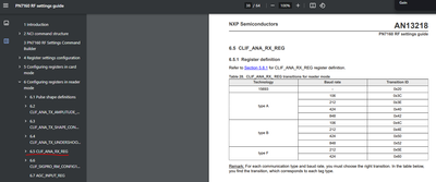

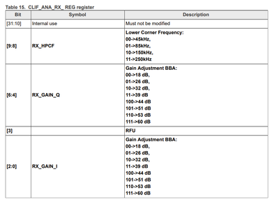

Back to your question. The other option is to adjust the Rx path. You can try to reduce the Rx gain. It will reduce the reading distance as well.  The default value for RX gain is typically between 60dB-51dB. So you can try going down to e.g. 39dB or 32dB
For more details, see the PN7160 RF Settings guide:
Tomas
