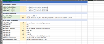

Then further reduction can be done using DPC settings. The idea is to use just one DPC entry and adjust the GSN value as shown below:

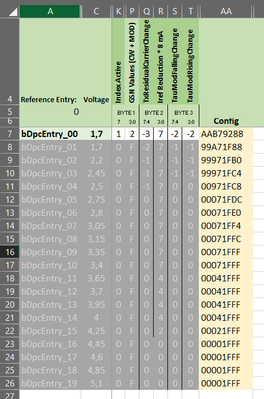

DPC Settings:
The DPC Entries (1-19) have been deactivated (Index Activate ->0), and only Entry 00 stays active.

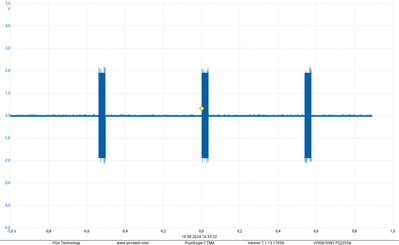

An example (RF Field measured using a scope probe):
No DPC, TXLDO 5V

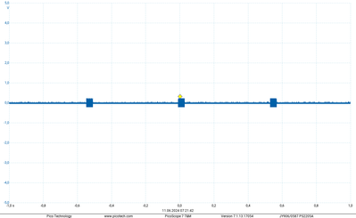

NO DPC, TXLDO 2.7V

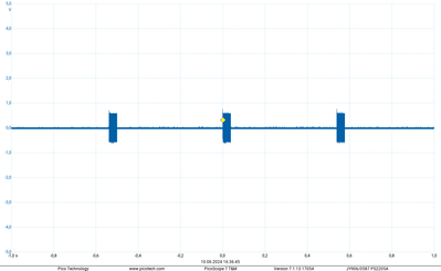

DPC Activated, One Entry, GSN-> 0x05
DPC Activated, One Entry, GSN-> 0x01
Please consider that the reading performance will be impacted.
