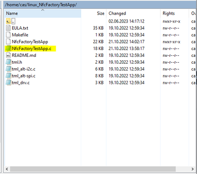

Tomas_Parizek
Hello Alb,
Can you try the same with the code I attached, please? It should be the same as we used in AN13224.
You can just replace it in the linux_NfcFactoryTestApp folder as shown below:
Tomas

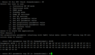

63,219件の閲覧回数
Alb
Hi Tomas,
get current always worked (109mA), I put the value in excel file from NXP to compute DPC command and I set it using "Set proprietary paramter"
20 02 5B 01 A0 0B 57 F3 13 90 09 0F 4E 0F 7C 95 B7 AA 7C 9F A7 99 A1 9F 97 99 B3 9F 97 99 B7 9F 97 00 C9 9F 07 00 CD 9F 07 00 DF 9F 07 00 E7 9F 07 00 F5 9F 07 00 F9 9F 07 00 0B 9F 04 00 0F 9F 04 00 21 9F 04 00 25 9F 04 00 37 9F 02 00 46 9F 00 00 51 9F 00 00 63 9F 00 00 76 9F 00 00
and software answer is "Proprietary parameter successfully set" so everything seemes to go well till this step. This is what I have reading DPC register
It's the same data. Even changing a little bit antenna matching and setting different value for the current has the same result: DPC Check can not extract values.

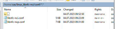

Tomas_Parizek
Hello Alberto,
Ok, thanks! The IC FW should be the same on my side.
What about the "libnfc-nxp.conf". Can you share this file, please? I would like to compare our settings.#
You find it in the conf directory.
Tomas

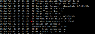

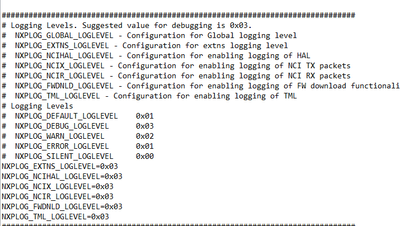

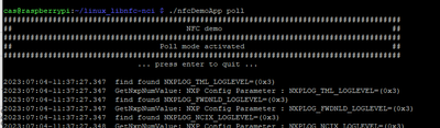

62,836件の閲覧回数
Tomas_Parizek
Hello Alberto,
You can check your FW version.
1. Set all "logs" to 0x03 as shown below (in libnfc-nxp.conf)
1.1 save it and do "make" and "sudo make install"
2. Run an example -> e.g. ./nfcDemoApp poll
3. Search for the FW version
Tomas
62,783件の閲覧回数
Alb
Sorry,
Now I found it: 12.50.5 so no dpc chekc at all
