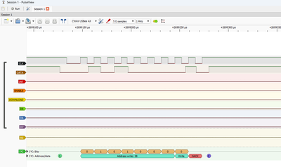

KaiLi
Hello @KennyG
From the logic of I2C, the communication is abnormal between pi and PN7160, I also have tested on my side everything works fine. So, it's recommended that you should check the connection between pi and PN7160. The below I2C time logic is from my side for your reference.
