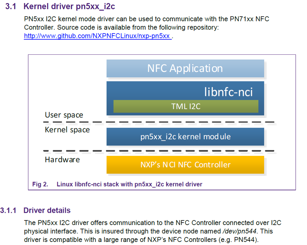

Hi All,
For PN7150 kernel driver, there are different chip names like pn544,pn547 and pn548. Among these which one we have to choose for PN7150 kernel driver.
Thanks and Regards,
Siva
2,671 Views
weidong_sun
  Please refer to AN11697.pdf! the link is :
PN7150 | High performance NFC controller for smart devices | NXP
---PN71xx Linux Software Stack Integration Guidelines
Have a nice day!
