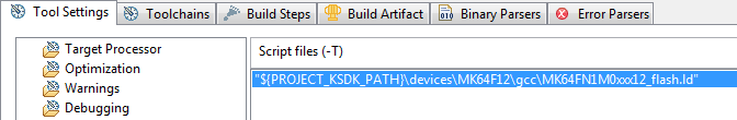

- Confirm that the linker file (MK64FN1M0xxx12_flash.ld) is actually present in that path.
- Give a check to the linker file path in the project settings:
- Also, looking at your console the error makes me think that the space in "KINETIS Demo" is still causing trouble. I would highly recommend you to place KSDK in the C:\nxp.

peter_furtner
Hi Jorge,
Many thanks for your support, the issue is now solved.
Under Cross-ARM C Linker –> General I had to Remove the “ at the begin and end of line and change the Path separator from ‘\’ to ‘/’. See below.
Peter
