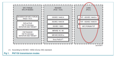

Hi @Electronics_Engineer ,
I think this feature is referring to the card emulation function, as shown below:
so this should not be what you are looking for. I think you are referring to the reader function, right?

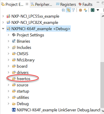

While it is possible to put PN7150 into autonomous tag detection, that requires the host controller runs some kind of RTOS, for example, freertos, which may switch to other tasks when the application set up PN7150 into a discovery loop, and then PN7150 may notify the host via IRQ pin in case of card detection.
The latest NXP-NCI_MCUXpressoExample_V1.6 provides such kind of demo for K64, in which FreeRTOS is used. Please kindly refer to the following for details.
you may download this package from the following link:
https://www.nxp.com/docs/en/application-note/AN11990.pdf
https://www.nxp.com/webapp/Download?colCode=SW4325&appType=license&location=null
