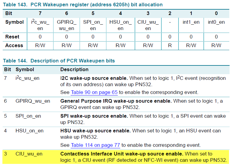

I tried to wake-up PN532 chip from soft-power-down with RF detector active but it didn't work. The circuit I use is quite smilar to the board from Adafruit (https://www.adafruit.com/product/789) Has anyone succeeded in the wake-up?
Do I need a stronger NFC magnetic field?

Please consider the next points for waking up the PN532 from Soft-Power-Down mode with the RF Field.
- The bit pd_rfleveldet must be set to 0 in the CIU_RFlevelDet register to have the detector active, otherwise it is disabled:
- The bit CIU_wu_en must be set to 1 in the PCR Wakeupen register to enable the RF Field detection wake-up event:

One more question is whether the RF detection Wakeup function will work with the Passive Tag or not

i also had problem like minkoocho, i followed your instructions but it still doesn't working, can you suggest more for me how to make it work

Thanks for your reply. But whenever I read the pin after I set the bit pd_rfleveldet to 0, It only says '1'.
Then, Is this be a hardware problem?
