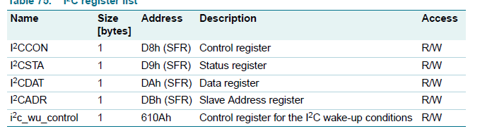

hongfengjiang
Hi,jacky
I also use STM32 +PN532 with i2c, but i can't get the connection. So i want to ask for you .
i want to discuss with you whether you use the follow register in your code. Thank you !

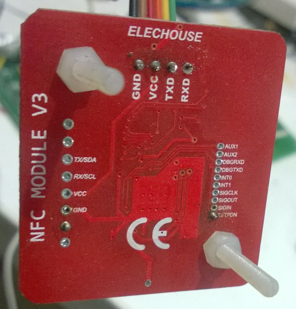

testbed
Hi Jacky,
I have used this module earlier, though with a NXP host controller. The company that makes this board is Elechouse in china and they have stated on their site that there are many counterfeit versions of their designs available and it is recommended to buy directly from them. I had same problems earlier, no response from chip, IC getting hot after sometime etc. I would therefore suggest to buy the nfc board directly from their site. This is the bottom silk screen of the board that i have. This is the original...
I would also suggest to use the IRQ mechanism of PN532 to read the ack and response together with a timeout. In my case i had written a state machine to handle data from pn532.
7,412件の閲覧回数
