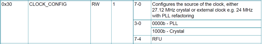

I am now trying PN5180 operation by PLL with 12MHz crystal. (Before, I tried PN5180 with 27.26MHz and it can operated successfully.)
My question is how should I set the related register to operate PLL mode, because I cannot get 13.56MHz.
I confirmed the crystal is oscillating 12MHz. However, the frequency of RF out is also 12Mhz.
I think I miss some settings of necessary registers.
So, please tell me which register and/or which bit should be set and what value should be written?
I appreciate your advise as soon as possible.
   S. Miwa

An external clock can be used instead of the 27.12MHz crystal, although not recommended since it decreases Rx performance.
In any case if you want to connect an external clock please notice there is a mismatch in the datasheet. It shows the EEPROM options are 0x0 or 0x08:
This should be instead like next:
0x03 -> default = internal clock
0x00 -> external clock
The datasheet will be updated to reflect this.

The PN5180 does not support external crystal other than 27.12 MHz.
Maybe you got confused by the fact that it supports an "external reference clock" of 8 MHz / 12 MHz / 16 MHz / 24 MHz. This is not a crystal.
If you wish to use the PLL with an external 12 MHz clock then you must update the settings via the EEPROM memory. To provide an accurate answer I am checking with the experts about what are the exact values you must save in EEPROM to use such configuration. Please let me reply back with their feedback.
