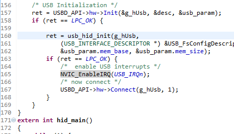

Thank you for your reply, i do not know if i can post my whole code, because it es part of a bigger project.
but i found out that the USB HID Device is the problem.
In one of my processes i have the Generic USB HID Example of the LPC1769. When it enables the IRQ my queue loses all the information, But the amount of available Stack elements is still right. When i erase line 165, i have no problem to transmit data through the queue, but then i cannot connect the USB Device.
I am creating the queue before the Taskscheduler and calling it from the USB ISR and a few other Processes.
Update 08.03.18 - 8.21:
The problem accurs when i try to send information from a task to the usb interrupt. Sending from the interrupt to another process is no problem

Hey Kan,
thank you very much for the fast reply. I supposed that it is not a problem with the nfc, but the freeRTOS is implemented in the nfc example. This is the reason  why I have called the NFC forum, maybe i should replace it into a FreeRTOS topic.
I had already implemented xQueueReceiveFromISR() in my functions but it does not change anything. I think this special function are needed for interrupting another task, but my problem starts during the startup of the program when no other tasks access the data of the queue.
The USB example i used to config my program is
usbd_lib_hid_generic - LPCOpen
And the FreeRTOS Implementation comes from the
NfcrdlibEx2_AdvancedDiscoveryLoop - SW352221
Could it be that the interrupt of USB is in a wrong Momory Area and this causes the fault because it cannot locate the queue?
