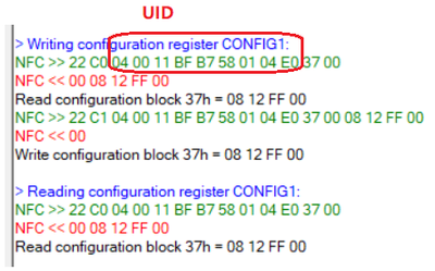

We have the default password 00000000h enabled on a NTP5312 NTAG5 device.
Our Android App follows the Application note AN12366 example 7.1 to run the password authentication but found that "Error I/O failure" always returns after the SET_PASSWORD command.
The command sequence is shown in the attached picture. Could someone help?
Thank you for your kind attention.

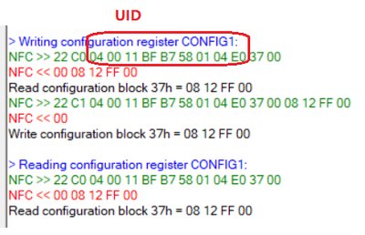

Hello @kiku541
Please follow the below frame foramt to access NTAG 5 via NFC interface.
