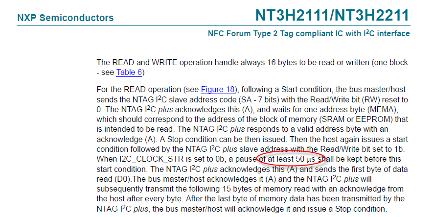

Thanks for the information! Referring to Memory Loc.png, it looks like the delay is too short between the first stop condition and the second start condition. The data sheet recommends at least 50us, please refer to the following for details.
Hope that helps,
Kan

I already did the delay in a earlier try and it did not make any difference. And the documentation is saying "when I2C_CLOCK_STR is set to 0". It looks like it is default set to 1, so I read it as being not relevant.
